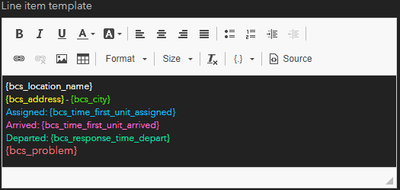

This is a big help. I need a bit more help with it since I'm not to familiar with Arcade.
Do I replace d1-d3 with
{bcs_time_first_unit_assigned}
{bcs_time_first_unit_arrived}
{bcs_response_time_depart}?
How would I call the function in the line item template to have just CST show?
Thank you so much again Josh!

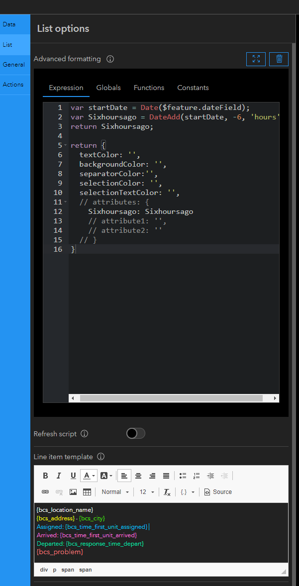

jcarlson
MVP Alum
Up in the Advanced Formatting area, you'd add these converted times to the attributes section, like this:
function GMTtoCST(d){
    return DateAdd(d, -6, 'hours')
return {
    attributes: {
        assigned: GMTtoCST($feature.bcs_time_first_unit_assigned),
        arrived:  GMTtoCST($feature.bcs_time_first_unit_arrived),
        departed: GMTtoCST($feature.bcs_response_time_depart)
Then in your line item template, you pull out individual attributes like {expression/assigned} and so on.
