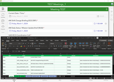

Thanks for the help.  I was able to update my DateDiff calculation and patched the hole in my time bucket as you suggested.   I am still having trouble with the colors working.   If I set the text color for example my meeting1 variable, it just returns the first color choice and does not honor the colors chosen for any time passing.
Any additional advice?
Charlie

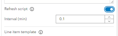

JenniferAcunto
Do you mean the color is not changing as time progresses? You will need to set a refresh interval if the dashboard is left open and is not being refreshed.

Thanks for the help with this.  I was able to update my draft and I have been able to get my colors to update as the time changes.
So new issue, is that my boss would like to see some of the meetings to have a preset time each day.   Meeting 1 - would be at 7am every day.  Is there a way to use the now() feature or something like it but keep a default time in place?
JenniferAcunto
I assume you are doing this calculation in your survey. I would not use now(), instead use today(). Today() sets the time to noon, so now that you have a set starting time everytime, you can add a calculation to it to move the time accordingly.
For your example, 7am is 5 hours behind noon, so the calculation will be: date-time(decimal-date-time(today()) - 0.2083333333333333)
5 hours  = 1 (day) / 24 (hours) * 5 (hours) = 0.2083333333333333
You might want to check out Dates and Times in Survey123
- Jen
Charlie_Kaufman
Jen.

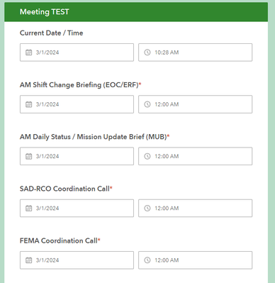

Thanks for that, the calculations are doing exactly now what I was hoping to see.  Now however, they are not following through to the Survey123 form.   Any thoughts on this?
JenniferAcunto
Remove the today() from the default field. I'm also noticing that today() is using midnight in the browser instead of noon, so if this is going to be a browser based survey, you will want to adjust your calculations accordingly.
