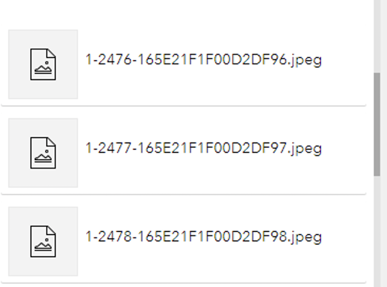

Ever since acquiring ArcGIS Enterprise, I am having issues displaying image attachments in the new ArcGIS Dashboard and Experience builder applications. This specifically affects reference layers i.e. layers published from our EGDB not hosted. We upgraded to 10.9.1 hoping that the issue would be fixed but it appears that reference layers still do not display.
In both the ArcGIS Dashboards details widget and Experience Builder feature info widget, the image only displays a greyed out thumbnail as below:

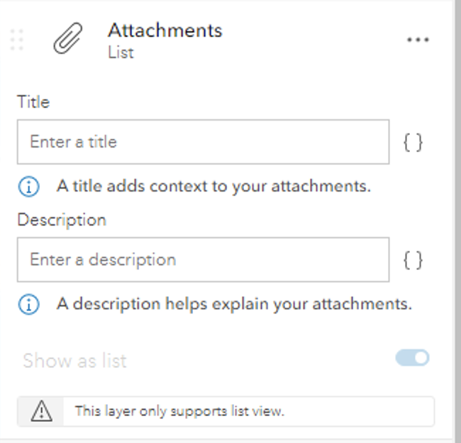

I went to the map viewer to try and turn off list view to see if it can display in gallery view but I get the error, this layer only supports "list view".
For our current workflow, we really need the images to display in both applications and it is crucial that we use reference layers as opposed to hosted layers. Is this a know bug and if so, how soon do we expect it to be fixed? Otherwise what could be the issue here? @DavidNyenhuis1 / @DavidMartinez / @TonghuiMing

Hi,
For Experience Builder, this is a known issue in Enterprise. We plan to fix it in 11.0.

Wei_Ying
Please note that:
"Server-based layers from
ArcGIS Enterprise 11.1 onwards and hosted feature layers from 10.9.1 onwards can display attachments as a list or in a gallery. Layers from versions earlier than 10.9.1 can only display attachments as a list."  Configure Pop-ups
If you are using 10.9.1 and encounter this issue, please try to use hosted feature layers see if the problem still happens.
