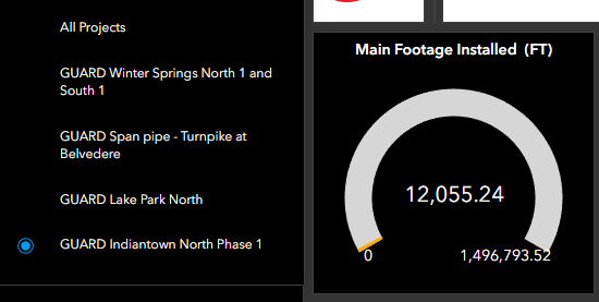

Is it possible to have the Maximum Values update on the gauges to reflect numbers for a specific project when that project is being selected using the category selector?  The values related to that field do update, but I would like to have the max value update along with it.  Any help would be greatly appreciated! Screenshot 2023-08-02 114042.png

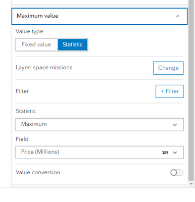

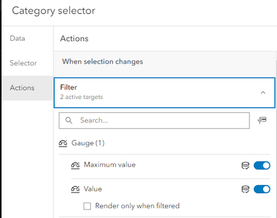

If you set the maximum field to a statistic in your data, you will be able to select it from the actions tab from the category selector.

Robert_King
That worked! Thanks Jen!!
