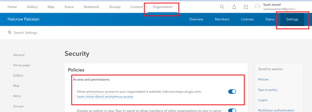

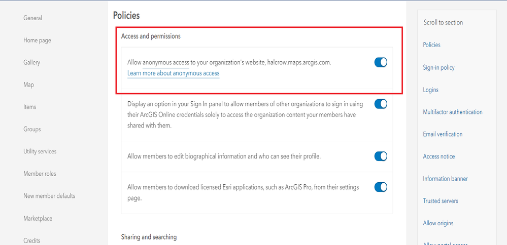

SyedJawad
the possible work around is as follows ...may solve the problem:
First you need to enable the permissions to allow everyone to access your shared content outside your organization for that you need to first go to the home page of your organization…then go to the settings…..in settings tab go to the security on left side of the page…..within the security tab go to the policies and enable “Allow anonymous user option ’…shown in the picture…..then go to the sharing and share the dashboard again using short url and you will be good to go Arcgis Dashboard 2.pngArcgis Dashboard 2.pngArcgis Dashboard.pngArcgis Dashboard.png
