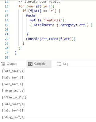

I tested a couple things in case it was something I did wrong in Pro. I'll use the Alcohol field as an example.
  • I looked at the data table of the hosted feature layer and clicked on the detailed view of the Alcohol field. It shows a total of 48 "Y"s. But the Pie Chart shows 42.
  • I tested swapping out the pie chart data source to the hosted feature layer without any Arcade expressions and grouped by the Alcohol field. It also resulted in 48 counts of "Y".
  • I added some Console statements to check on the counting and it seems to be counting correctly.
