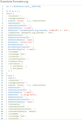

Hi everyone,
we got a request from a customer if it's possible to trigger the execution of Arcade expressions after using an action filter in ArcGIS Dashboards.
The background is that the customer displays statistical data. If the total number of records selected falls below 3, no data should be plotted on the graphs. The "refresh" option cannot be used because, statistical data that are subject to confidentiality would be visible for a short period of time.
The customer was able to successfully implement this for the indicators widget, but not for the bar charts.

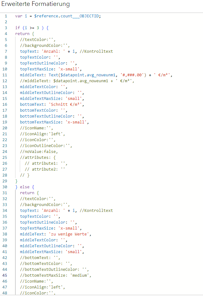

The expression for the indicators looks like this:
Any hint, even if it shouldn't work, is welcome.
