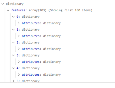

I'm guessing this an Enterprise Portal dashboard?  It's likely things such as DateDiff() aren't present in your Arcade version.
Jabousaw
It pops up as one of the functions I can use and I rewrote the code to manually calculate the difference in time using conversions and it gave me the same error.
KenBuja
MVP Esteemed Contributor

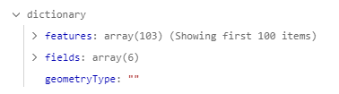

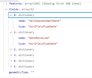

You're using Push incorrectly in several places. I've restructured your code a little bit and it returns the Dict.

However, is your intent to just have one record for the maximum, minimum, and average waiting times for your indicator? All of the records in your dataset will have the same values for these three times.
Jabousaw
I'll have 3 separate indictors, one displaying maximum, minimum, and average waiting times, respectively since I don't think I can have 1 indicator showcases all 3 values. It's also easier to look at when having 3 separate indicators. Also, the code you provided ran but I don't think it outputted the correct information, as it just outputted a bunch of text and no numbers.
KenBuja
You can use this code in each of your indicators
