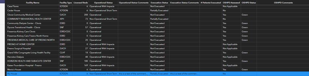

Ops Dashboard now has the Table Widget which is great. Is there a way to use Arcade to allow the table to "Wrap Text". It seems like the table is designed to display a set amount of characters and not a field for longer comments.
see comments that has the etc.. It does not wrap the text.see comments that has the etc.. It does not wrap the text.

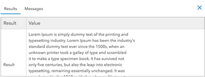

Here is an Arcade script for wrapping text.
Change the variable lineLength as per your requirements.
Cheers! - Gee Fernando
var longText = "Lorem Ipsum is simply dummy text of the printing and typesetting industry. Lorem Ipsum has been the industry's standard dummy text ever since the 1500s, when an unknown printer took a galley of type and scrambled it to make a type specimen book. It has survived not only five centuries, but also the leap into electronic typesetting, remaining essentially unchanged. It was popularised in the 1960s with the release of Letraset sheets containing Lorem Ipsum passages, and more recently with desktop publishing software like Aldus PageMaker including versions of Lorem Ipsum."
// Split longText into individual words
var longTextarray = Split(longText, ' ')
// Characters per line before line break
var lineLength = 50
var wrapText = ""
var words = 0
var characters = 0
while(words < Count(longTextarray)){
    // Count number of characters per line
    characters += Count(longTextarray[words] + " ")
    // When number of characters exceed lineLength add a line break, otherwise add a SPACE
    wrapText += longTextarray[words] + When(characters >= lineLength, "<br>", " ")
    // When number of characters exceed lineLength, reset characters variable back to 0
    characters = When(characters >= lineLength, 0, characters)
    words += 1
wrapText
