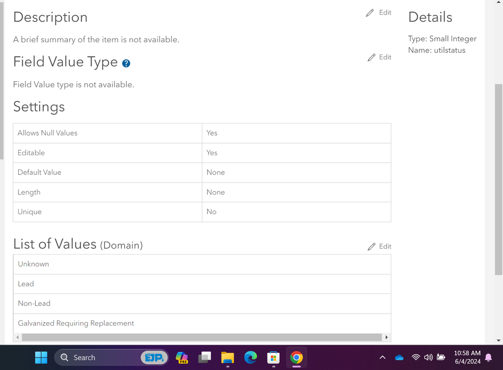

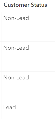

Here are photos to try and help solve this issue. I am not entirely sure I got the correct field settings in the photos, so if something else is needed, let me know.
Screenshot (1).pngScreenshot (2).pngScreenshot (3).pngScreenshot (4).pngScreenshot (5).png

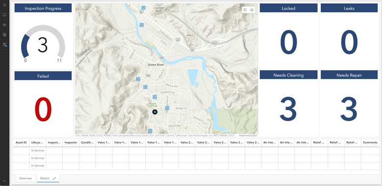

I am experiencing this issue as well. Here is a screenshot of my table in the Backflow Inspections dashboard. These records are all fully populated, but do not display as such.

I was having the same issue. When looking through everything I noticed that the Advanced Formatting values was on, which I intended. However, I had enabled advanced formatting prior to adding certain columns and those newly added columns were not in the advanced formatting script. I turned advanced formatting OFF and then back ON again. The result being that the script was refreshed all columns of data. Unfortunately I had to reapply any custom formatting I had previously written.
