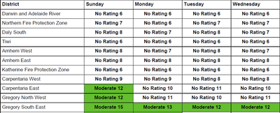

I want to use an advanced expression to split the table out to
  • One District per row
  • Columns for each of the four days.
    • dd/mm/yyyy or the actual day. (Monday, Tuesday, etc).
  • The Fire Danger Rating in each of these columns for the appropriate days
Final end goal looking to replicate:
I have been looking through the posts and samples, but yet to find anything that helps dimension a table in this way.  Can someone give me some pointers or similar examples they have seen to get me started?  New to Arcade.
I was thinking GroupBy might be the right approach? But the expression statistic type is geared more to working with numerical data.
I suspect I am missing something quite obvious here.
