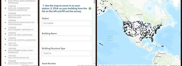

I am pulling data from a feature service (from the map) into the survey123 within this dashboard and I can make it work with this code (major help from colleagues getting this far!) -
?mode=collect&field:Station={CCCODE}&field:buildingtype={Asset_Code}&field:Asset_Num={Asset_Num}&field:Comments={Comments}
But this just brings in the domain code.  I really need the domain description to copy over not the code. The users need the description.  (I don't really want to build the descriptions into survey123 connect)
Any suggestions?  Thank you so much!

Are you able to upload a higher quality screenshot of your Dashboard and embedded Survey123 element? It's a bit hard to make out but if your 'Station' question is getting prefilled by the CCCODE attribute of the selected feature in your map, is that alphanumeric entry not what you would expect?

Yes, the CCCODE is the field name and the alphanumeric entry is the domain code not the description.  The description is the full station name.   Thanks for thinking about this!

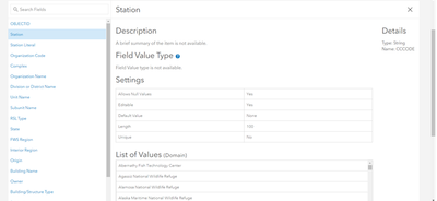

Can you provide a screenshot of the 'CCCODE' field configuration from the 'Data' tab of the feature layer in your web portal? Displaying the List of Values (Domains) and their codes?
If you open the attribute table in a web map, do the codes display under the 'CCCODE' field? or do the descriptions display?
KirstenLukeACJV
And when opened in a webmap, the table view shows the description not the codes.  I cannot find a way to display the codes with the descriptions though, to show you.

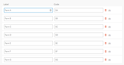

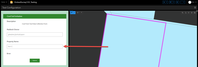

I've replicated a field similar to yours:
With Domains where the descriptions and codes differ:
My Survey XLSForm has no choice list configured for the corresponding question/field
And a similar URL scheme in my Dashboard: https://survey123.arcgis.com/share/f0f49fbf66ed487883ece613d465ec1c?field:pad_username={username}&fi...
And the description passes successfully:
I think we need to get more information about your layer in order to understand why it's not working. Can you answer the questions at the top of this reply?
