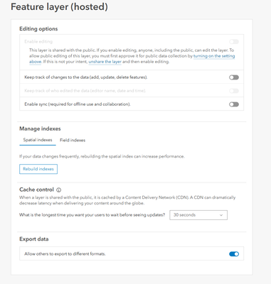

Ensure, in the hosted Feature Layer / Table that Export Data is enabled.

Hi! My layer is not the hosted layer, so Export data is not in the settings. So, when I published the layer from Pro, I enabled the "Data Export".
Is the Source Data Download in Dashboard is only for Hosted Layers?
