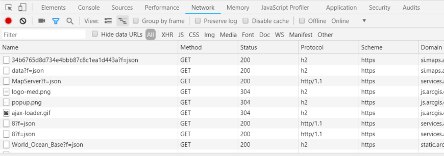

If the above does not work, can you ask them to click F12 on their keyboard while at the point in the storymap where it breaks, and see if there are any errors in the Network tab:
This might help diagnose why the app isn't working in the storymap.

The only error that occurs when pressing F12 is the following, but I'm not sure if that's relevant.
Invalid 'X-Frame-Options' header encountered when loading 'https://doildt.maps.arcgis.com/sharing/rest/oauth2/authorize?client_id=opsdashboard&display=iframe&r... 'ALLOW-FROM https://doildt.maps.arcgis.com' is not a recognized directive. The header will be ignored.
