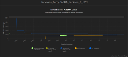

I'm trying to build a serial chart that contains dynamic point data and also includes line data to show thresholds for values.  These thresholds vary as we continue down the x-axis, so a straight guideline won't work.  The chart needs to filter the points by various attribute values, but the lines need to be consistent across all selections.  Here is an example of the formatting.

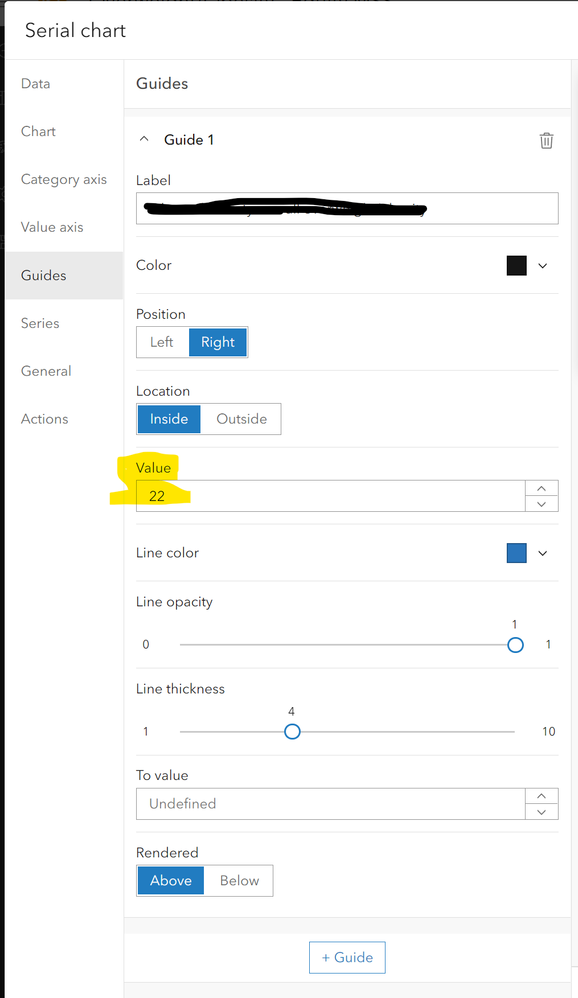

I'd also like a dynamic guide that is based on either a summary statistic of a field or on a filtered single value in a field, instead of having to manually type one. It has value as a static value, but in our use the guide is the comparison to a county value, so each year the county as whole will change, and the users will have to manually update the guide each year. This project happens to have about 25 dashboards involved.
Otherwise a point can be used in a series, but serial chart doesn't have a way to extend a line from edge to edge, it'll just show a single point so that's not as effective.
