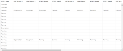

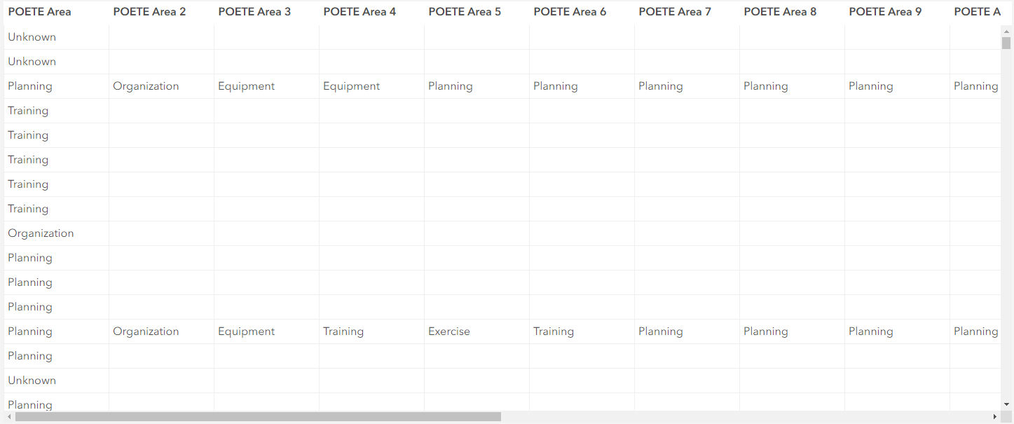

I am trying to build a bar chart illustrating the number of times a string is recorded across multiple (19) fields. I would like to get the total number of times Planning, Organization, Equipment, Training, Exercise, and Unknown appear in POETE area (poete_area) through POETE area 19 (poete_area_19).
This is what I have for my data expression so far but getting tripped up on it:
