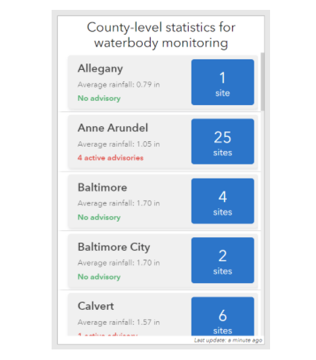

My goal is to have a list in the dashboard that looks similar to this:
Introducing Data Expressions in ArcGIS Dashboards (esri.com)

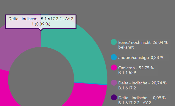

Where instead of the name of the County I will have the name of the variant and instead fo the “sites” I will have the percentage of that variant. It should look like the following graph, but as a list:
Only problem I have to sum up all Deltas first and then rename them simply 'Delta'.

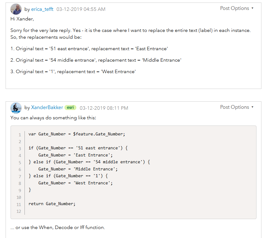

I Also wanted to copy from this example, but I don´t know how to reference my field correctly. Or if this could be use in a list widget.
https://community.esri.com/t5/arcgis-online-ideas/allow-multiple-replace-functions-in-one-arcade/idi...

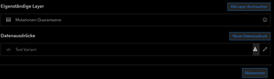

I tried out your script with a feature layer that has exactely the same data as in my example table, but althouth the test function gives no errors, I am not allowed to use the expression...there most be something wrong that I can´t figure out.
