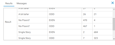

 It's hard to demo without access to the data, but here's a silly example from the Arcade Playground, in which I use SQL to reclassify the sample buildings layer by floor count, and also split the result by whether the objectid is even or odd:

Which returns:
