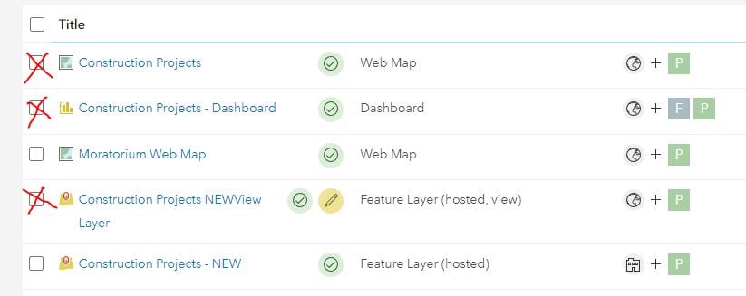

I have a Public facing dashboard that has a web map, which has 2 hFL (hosted feature layers), and 1 hFLV (hosted feature layer view). All of the layers, the web map, and the dashboard are public. I'm really familiar with this process, which should not be this difficult to diagnose, however, I am suddenly receiving a login prompt when I log out of Enterprise and try the link.
I would share the link here, but I believe our Enterprise deployment is set up so that nobody can access outside of out network - so that will not work.
You can see in my screenshot that all selected layers are public. I do not have the hFL at the bottom on the map, it is solely used for editing, hence why it is not public. The other two hFLs mentioned that are on the map are not on this screenshot, but are shared publicly.

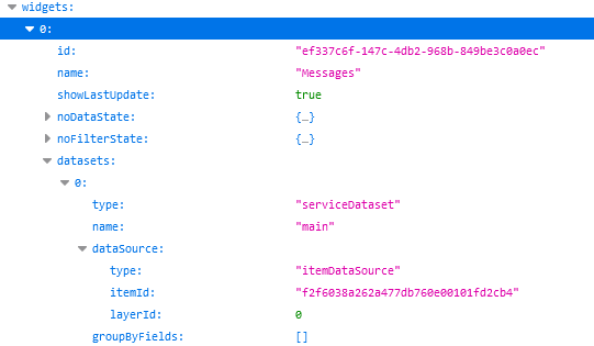

Thank you again for your help. My JSON definition does not look like yours, mine is just a page with all black text clustered together - no separation, like you have on individual lines. So I searched for widgets and I found that, but when I search by my dashboard's ID number, I come up blank. It doesn't say that it is found.
So, I searched by the Web Map ID and I found it. But I can't find anything called "operationalLayers" or "basemapLayers", I used to search bar for that. I also searched for View Layer, and hFL ID numbers (I don't know if they would be in here, but I tried anyway), and it did not find anything. It does have "layer ID" shortly listed after the dataSource, but it's an ID number that I cannot pinpoint to anything. Not the main layers that I am using anyway.
