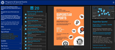

@WassimAmmane & @SteveRoth maybe the attached screenshot can help?

JoshBillings
No other steps for me. The images still show up at about 50% rather than filling the entire panel though.

JoshBillings
It doesn't fill the details pane quite as much as it used to, (it's at about 50%) but it works for our purposes.
