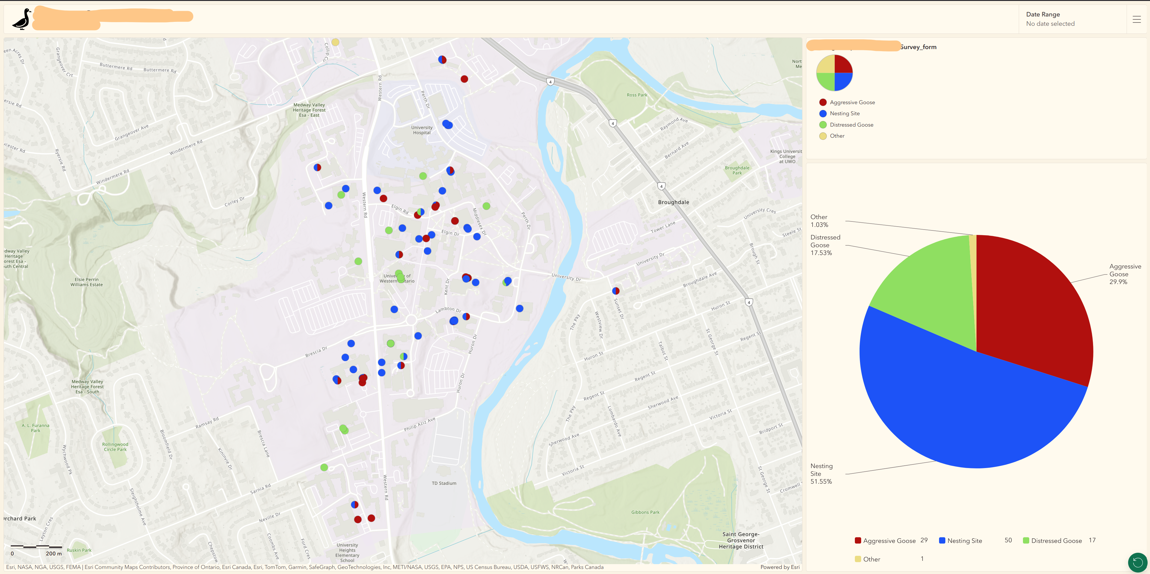

Dashboard:
This is what I'd like the PDF export to look like. This way, the user can specify the date range and create a new .pdf whenever they'd like.

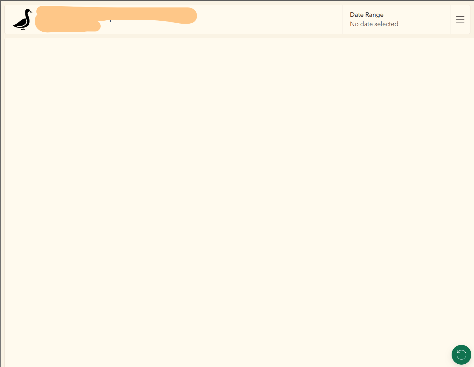

Firefox:
Neither the map, nor the legend/piechart appear?

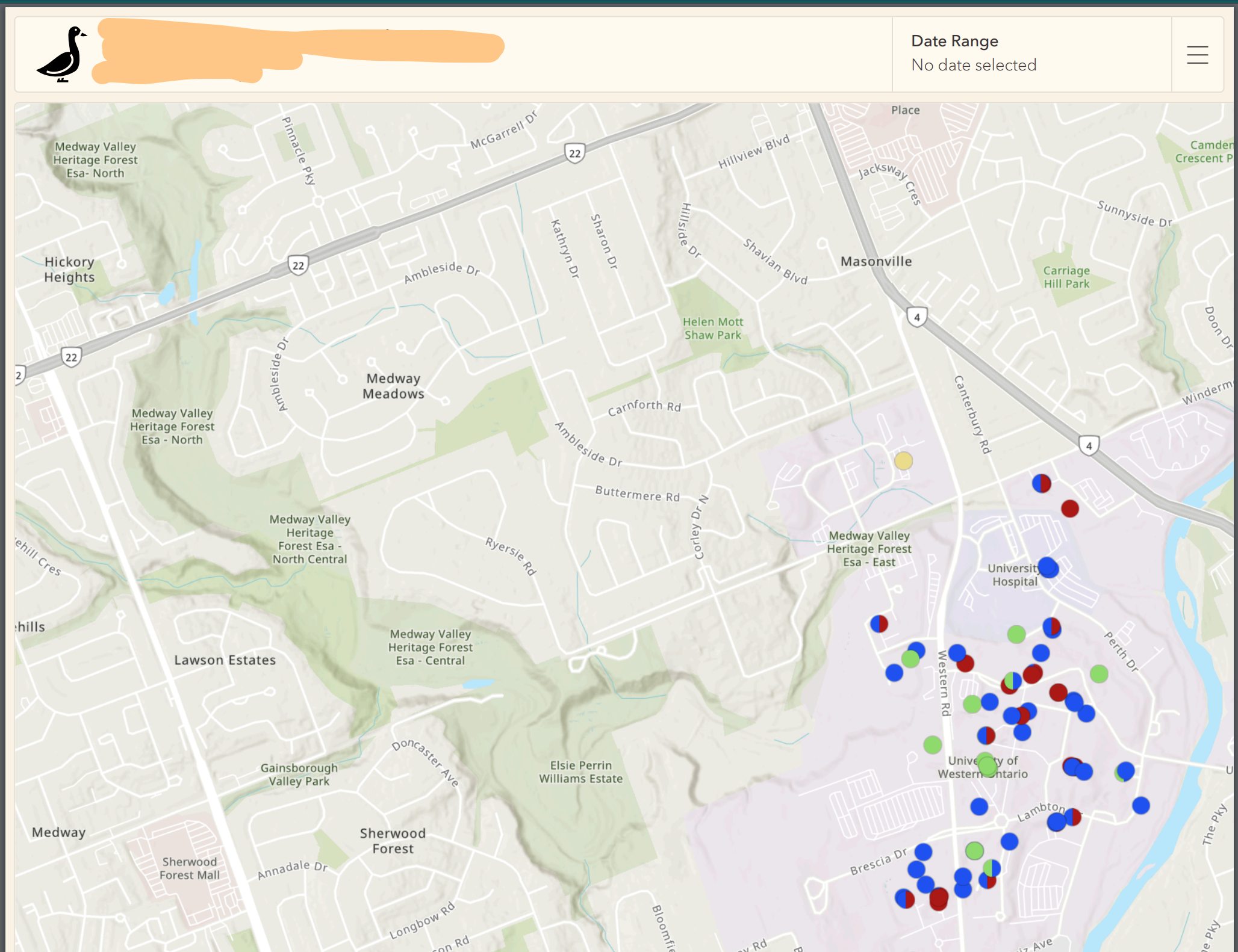

Chrome/Edge:
The map appears, but not at the correct extent. Also no piechart/legend?

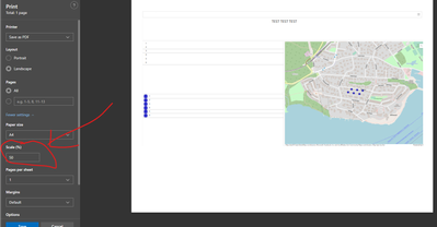

AndreasHall
Hi, I could reproduce this behavior in Microsoft Edge. By changing the scale you should be able to get the whole dashboard visible in your print.

DanTrudgeon
Interesting! I was able to get the whole dashboard visible using scale, there is whitespace at the bottom, but that can be cropped. Wonder why the chart and legend doesn't count as a printable area...
This gives me two workable options for the client. Thanks!
