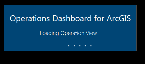

We have a client that is using operations dashboard and has no problems until today.  As of today he cannot get in to operations dashboard.  He gets stuck on the loading screen which looks like this..
We tried uninstalling and reinstalling operations dashboard, but he still is having the exact same problem.  All of our clients are using the same version and only this one client is having a problem.  Any help with this issue would be great. Thank you.
