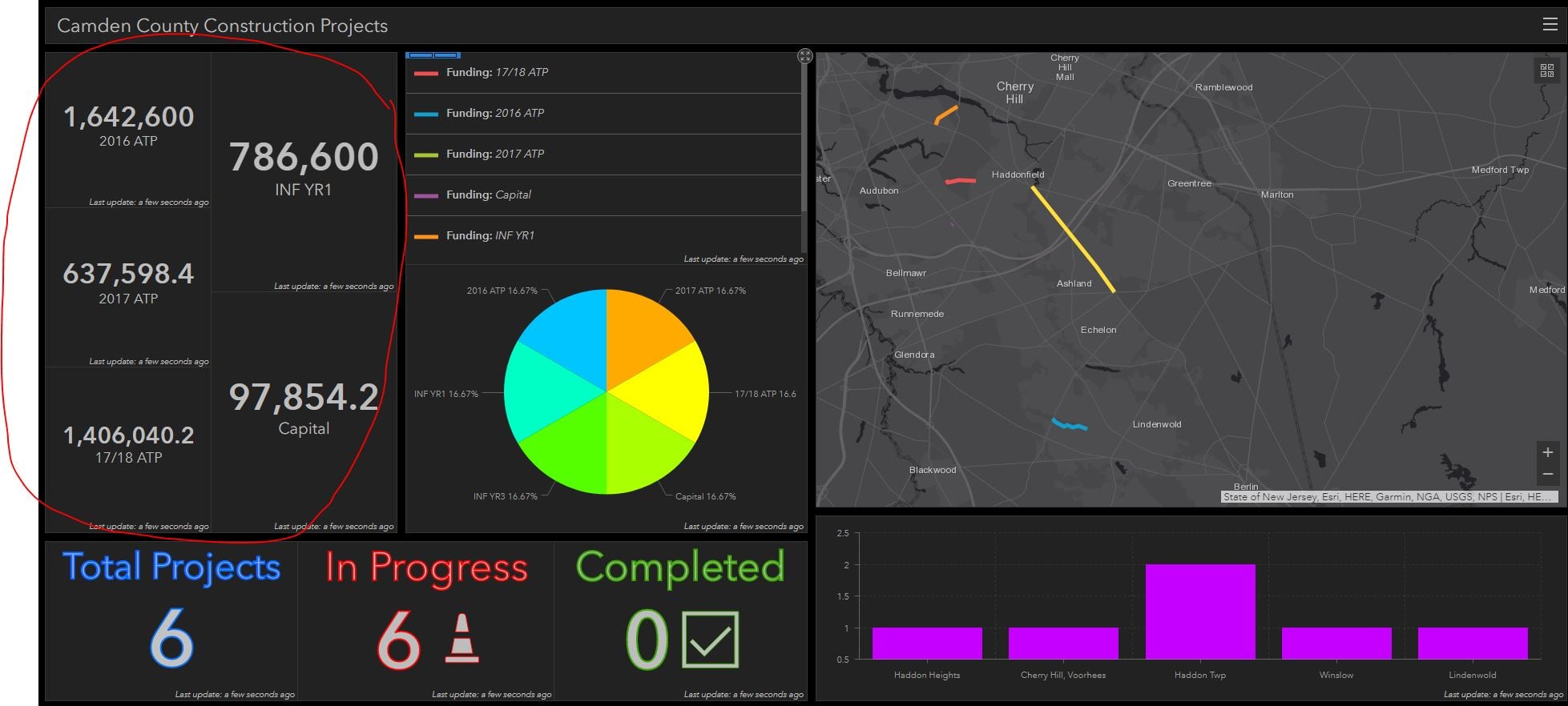

Hi all, I am brand new to Enterprise & Operations Dashboards, so I am trying to set up a sample for my department to give them an idea for what's possible.
Anyway - I cannot figure out how to add dollar signs in front of these numbers I have circled in the image below - it is an indicator. I've been looking on Google for a little while now and have come up with nothing. There is also no symbol of a dollar sign available on here, otherwise I would just select that.
Any ideas?

> ... I cannot figure out how to add dollar signs in front of these numbers I have circled in the image below - it is an indicator.
When you're configuring the Indicator element, click the Indicator sub tab, for the Value property, activate the Prefix option and enter a "$" when you format the value under the Pattern input box. See screenshot below,

Thank you so much!!!
