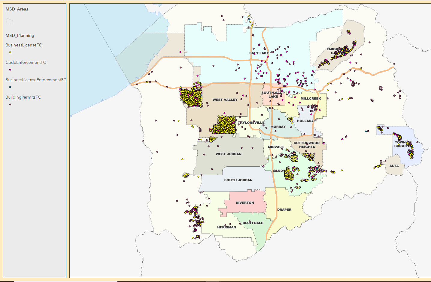

I have a couple lists, and a couple associated maps.  The lists are stacked on top of each other as are the maps. Is there a method such that when I activate a given list,  that activation will activate the associated map and vice-versa?

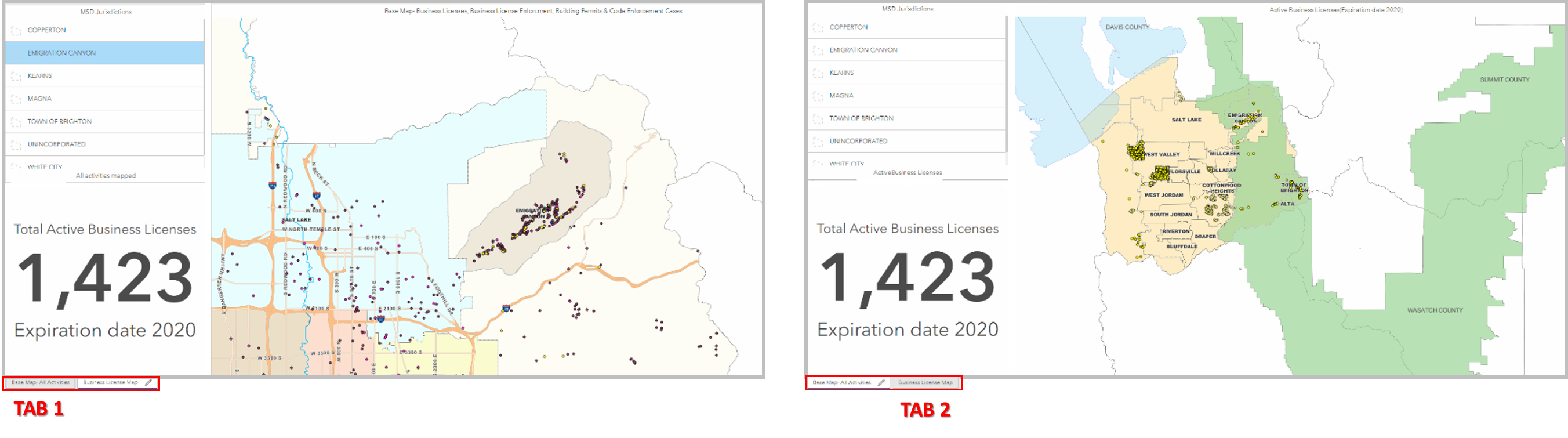

What you could do (in the meantime) is group (hold down Shift when moving) your first lot of List/Map/Indicator and group your second lot of List/Map/Indicator then stack the two groups. That way the list that matches the map is grouped with the map. You will need to duplicate your Indicator for this (to have the same layout for the dashboard). So you end up with two tabs for the dashboard. I have done this for a few dashboards to avoid confusion.

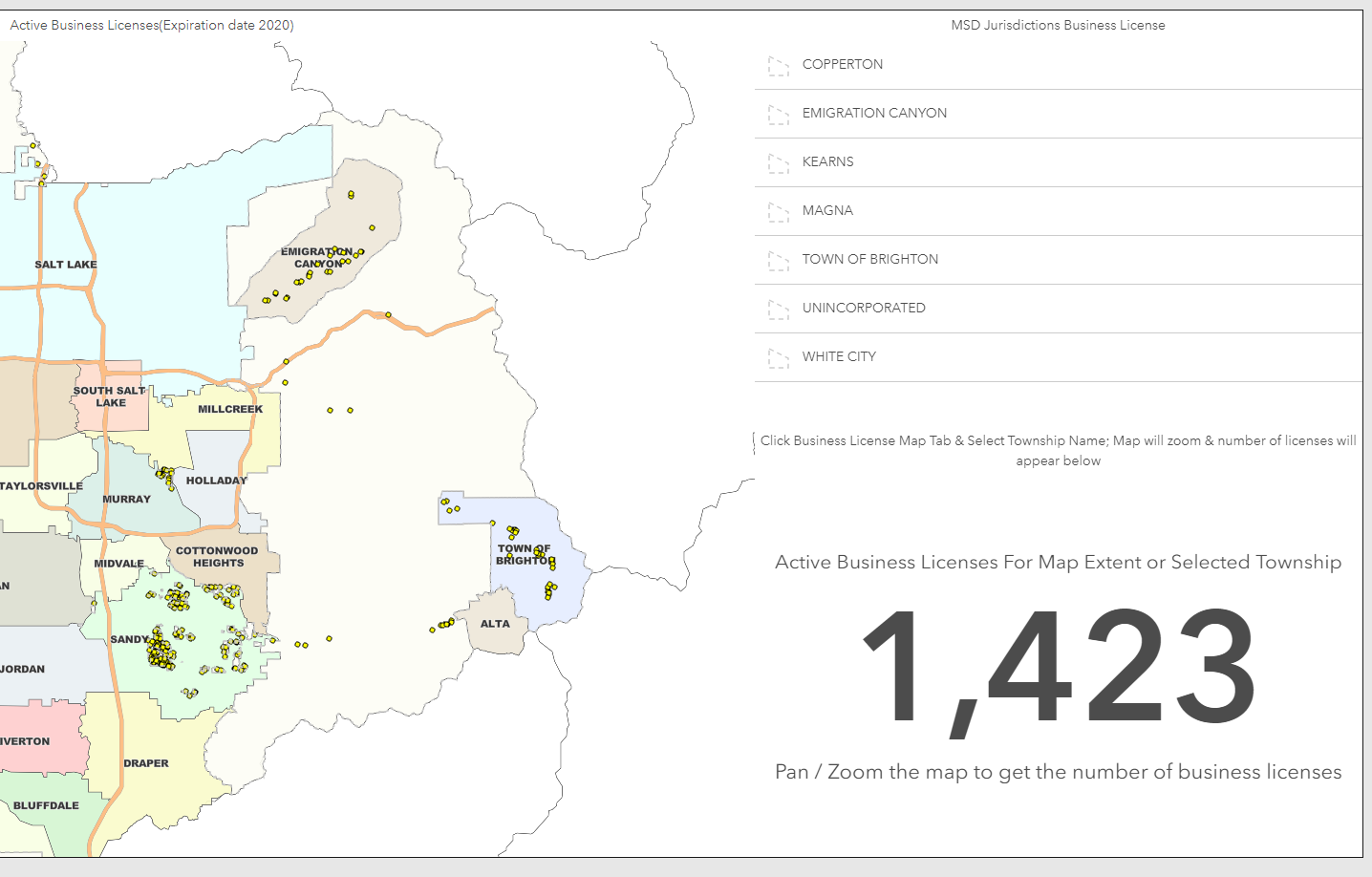

Once the items are grouped, it seems as though the borders between the elements go away; or am I missing some setting somewhere that will preserve them?
Simple, no-group:
Grouped elements.  no borders between the 3 elements:
That should just about do it....
JamesBurton1
Yea that's an issue with grouping. It's a pain to maintain, but you can create borders between your elements using rich text elements. That's how I had the housing dashboard set-up.

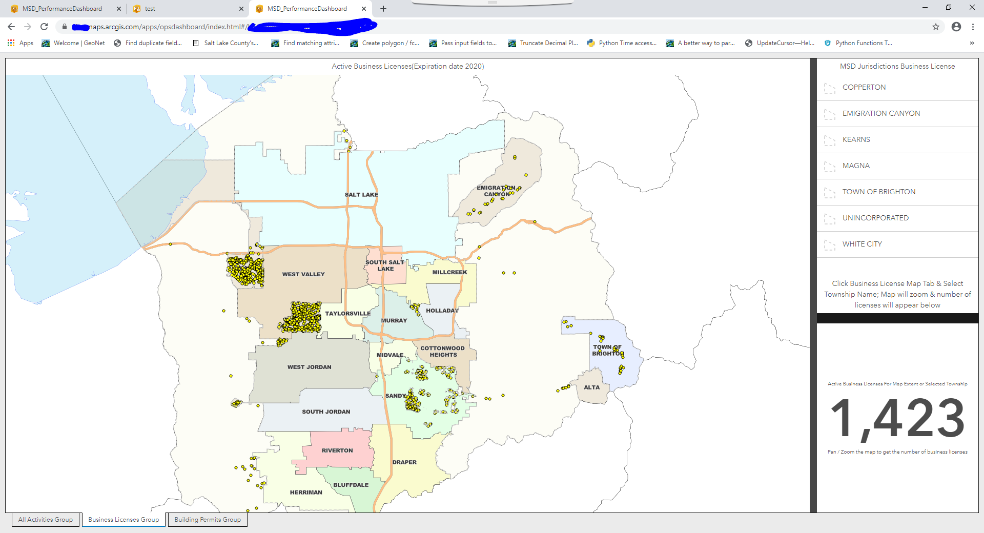

For those following along, here is an example of what James is suggesting: the thick black borders between the map and the list / indicator as well as between the list and the indicator are actually two rich text elements that I squeezed down.  Note though the difference in widths: hence the 'pain to maintain'.....
I think it's back to the drawing board for me.  I have a number of dashboards that need to be created, so I may just create them individually.....
