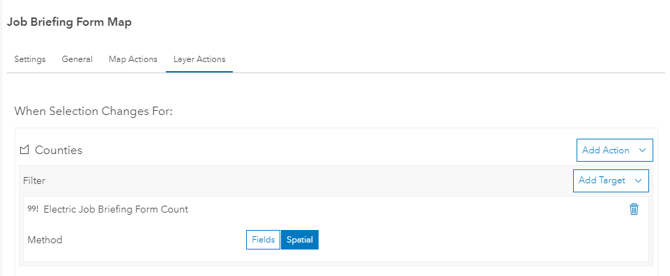

Thank you for that! I was able to find and configure the filter layer. The problem I'm having now is my count of jobs is not changing when I click on a county. The jobs outside of the selected county are no longer showing, but the count element does not update. Here is what it looks like on the back end
You will also have to set a filter action on the "count element", which I think is an Indicator element.
