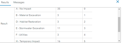

So I'd ultimately like to end up with something like the following:
CategoryFeatureCountFID
A - No Impact350
B - Material Excavation3  (i.e., 2 + 1)1
D - Habitat Restoration32
E - Stormwater Excavation11 (i.e,. 8 + 3)3
F - Utilities3 (i.e., 3 + 1)4
H - Temporary Impact16 (i.e., 14 + 2)5

ToddLusk
Thanks so much!  That was just about perfect but got me headed in the right direction.  Here was is my final implementation:
