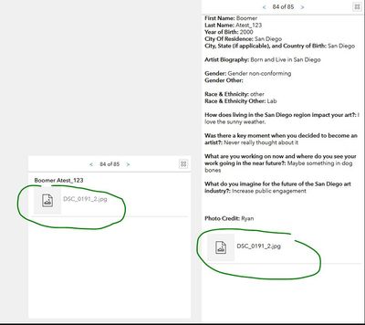

I am using Dashboards on AGOL, formally known as Dashboards Beta.  If I turn on Media or Attachments in the Details the attachments show super small, if they show at all.  Like a tiny thumbnail size. (see attached images).  The images are attachments on the feature layer.
In "Classic Dashboard" the image is nice and large, making for a much better user experience.
I want to use the new Dashboard as it does much better with arcade expressions.  How do I show attachments in a larger size?

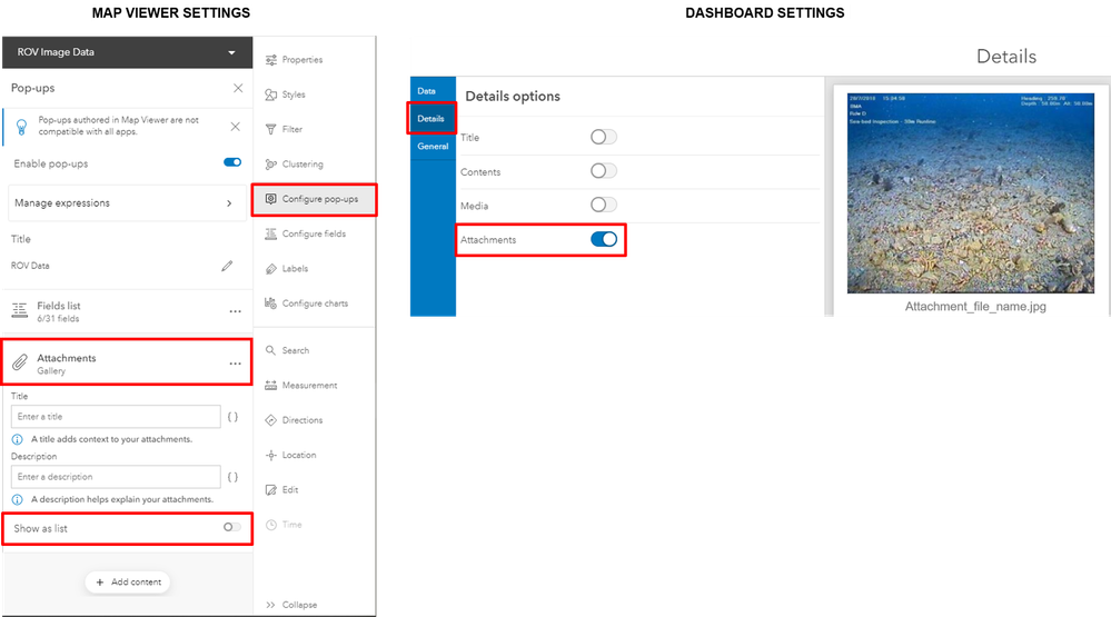

If you open your map in Map Viewer (not Classic), select your layer and go to 'Configure pop-ups', expand 'Attachment' by clicking on it (if necessary) and turn 'Show as list' off.
Then in your Dashboard, for the Details element, turn 'Attachments' on (rather than 'Media').

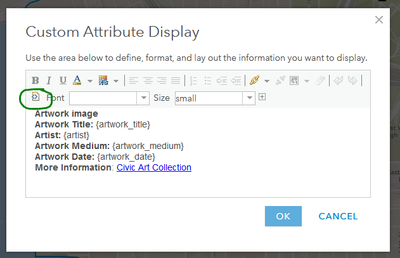

Sadly it seems the Map viewer (not classic) does not allow access to the html like classic does.  Meaning you can't set the display color via an arcade expression.  If you make a map in classic and then open it in the new map viewer it seems to work.  However that makes maintenance trickery.
