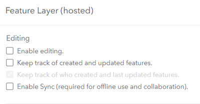

It is not a good practice to keep the hosted feature layer as a public data collection.
Please go to the Settings of "Bird Observation Khanbumbat" > Disable Public Data Collection. Also disable editing, if already enabled.
Save the settings. Share the layer with public. Check if the features of the layer are visible in dashboard.

I tried. But still same problem. I created new feature view layer and map. Sharing level is public. But still same problem. All layer values unable to see when change from owner to public. Anonymous setting is enabled.  :(((

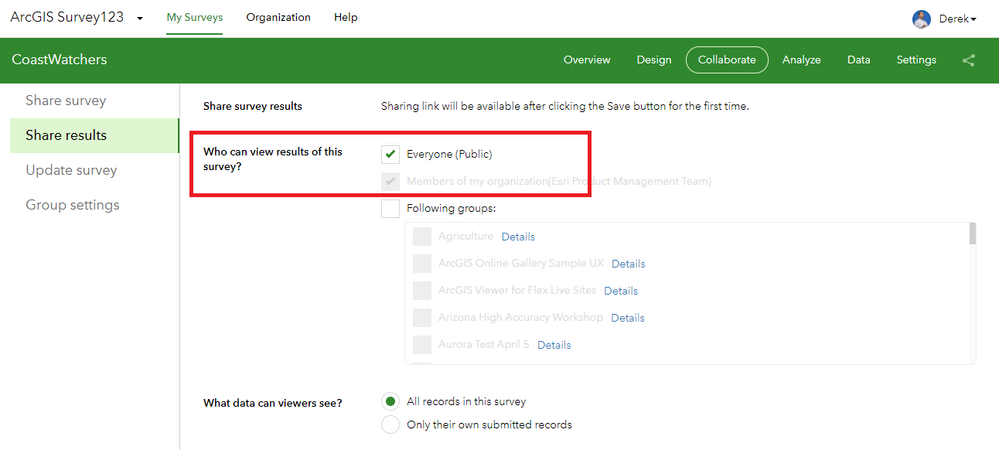

Just to verify, did you ensure that you also set the sharing permissions of the survey results to "public" as well? You can check when you login to the Survey123 website > select survey > Collaborate tab > Share results.

I set sharing permission of survey results to public. Layer and map also set for public view. But as you can see, layer values still not visible in Dashboards. It is only visible when I change layer status to owner. :((

Many for assisting me. Dashboards values are visible now. I was mistaken.
There was only "Fieldmaps layer" that was automatically created when I publish Survey form in Links tab < Survey123 Connect. Then I created map using that Fieldmaps layer not Stakeholder or General layer.  After that it is visible on Dashboards. But when I use Stakeholder or new created view layer, it is not visible again.
