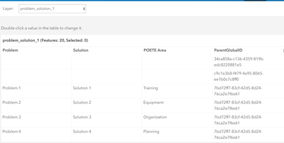

I have a table with records from a repeat question in survey123. I am trying to loop through and return all associated records and display in a list.
Table:
My attempt to use advanced formatting to get this to work:

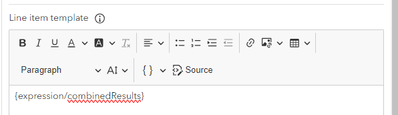

Line item:
Results = empty list:
My goal is to get all 4 problem and solutions shown above records to display

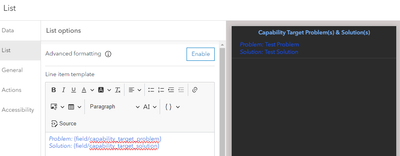

@jcarlson thanks for the feedback, Josh! I was probably going at this the wrong way and didn't explain my workflow in enough detail. I have a table populated within a dashboard with records from a Survey123 form. In that form, there is a repeat question creating a related table with the problem/solution responses I would like to display in the list. Within the table, I have a filter established to populate the list displaying all the problems/solutions (could be 0-30) associated with that selected record.
Table:
Filter:
Current list (returns only first problem/solution)
Current list configuration:
Repeat table:
My desired outcome would be to get all 4 of the related Problems/Solutions to display in the list from the selected record in the table

dwold
@jcarlson that was it! I had  Maximum features displayed set to 1. I bumped to 100 and they all display. I should have caught that. Thanks again for your help with this, it is always appreciated!

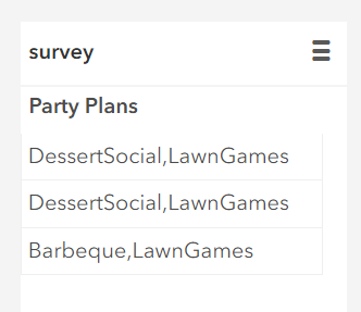

Basically, I want to do a loop of any multiple choice selected answer from a survey123. The issue is that they get submitted like this:
Which A) I need spaces and B) makes it difficult to create a list. Would using some similar syntax to what you have above (for var x +=) work for something like this? I am still learning more advanced arcade expressions so looping and adding to a list is something new for me!
