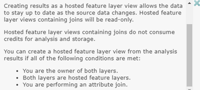

I did as you suggested but still appear to have a layer that is a snap shot in time that does not update when the records are updated. I did a bit more homework and it appears what is created when you do the Analysis -> Summarize Data -> Join is a read only (view) layer. See below. The layer does have a rerun analysis option but then you must rename so not what I want. Am I missing something?

In the screenshot you posted, it says "...hosted feature layer view allows the data to stay up to date as the source data changes."  This means it will dynamically update if you update either the sites layer or readings table that went into creating the view.  It is read-only in the sense that you can't make any data changes directly to the view itself, only the underlying sources.
In the Join operation, what options are you using?  Make sure you are joining in the most recent reading to each site.
