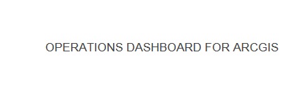

As for the other folks, it appears that my machine is the only one that will load properly within our network.  All the others get stuck at the web page and the below image is all they see.  However, I have tried it on computers outside our network and the dashboard loads fine.  I am going to get with IT to see if its a permissions thing in house.  I will post if there is a resolution that might help others.  Really appreciate your help, we are excited to utilize the dashboard both internally and for our clients.
