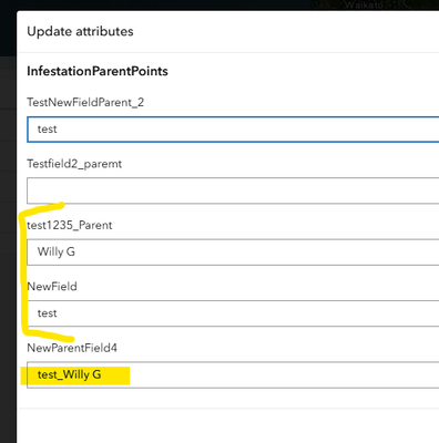

WillyG
Hi @KenBouchard  and anyone listening at ESRI. I've just tried a basic concatenation of two fields as a calculated expression and that is working fine, so my hunch is that accessing calculations via $map FeatureSetByName is what is borked currently in dashboard table edits

Getting this error with: FeatureSetByName($map
SandraLuken1
There is an update expected in a few hours that should address this issue.
