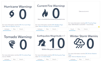

So I have been trying to replicate the following indicator/map/details as shown in the following screenshot. The screenshot was captured from FEMA Geospatial Resource Center. Now let's say I want to get the Hurricane info from USA Weather Watches and Warnings.
How can I first add the layer to an indicator? Because when I use my organizational account to add this layer to an `Indicator`, it does not give me the option to add data from the `living atlas`.
How can I then connect the indicator to get the `Hurricane Watch` data (live data) from this layer?

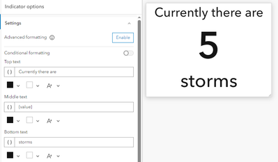

IssyAmis
Hi @Ed_
You should be able to achieve this through the "indicator options" settings on the indicator. If you take a look at my screenshot below, I believe this is a basic version of what you are hoping to achieve:
In terms of returning the names of the storms, I'm not too sure this will function well in an indicator as this may be a lot of information. You may instead what to look into using a list widget alongside this to show the list of storms?

Lastly, how can I add a hurricane icon similar to the one shown below to the indicator card?
PS Apologies for asking multiple questions at once.
