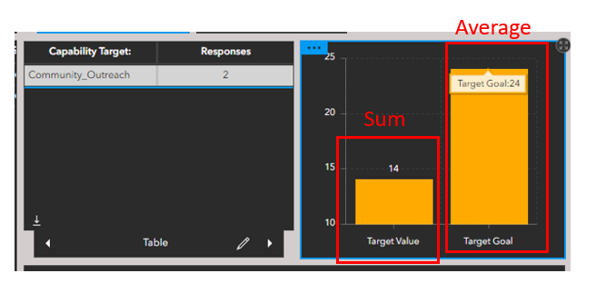

I am trying to write a data expression that finds the count of that field. Then calculates the average of a field (filter/selection dependent) and use that in a bar chart along with the sum of another field.
In the picture below, I am trying to get the Target Goal to be 12 (24/2 records) while the Target Value (14) is the sum of 2 values.

Remember, you need to return a FeatureSet from a Data Expression. Also, in a Data Expression, there is no global $feature.
You can get the count and sum both out of a GroupBy function, and even do some derived values involving multiple fields.
The tricky part is "filter/selection dependent". Aggregating in a Data Expression is going to break any kind of per-feature identification in the data.
Are you wanting the "goal" value to come from the selected feature? I don't believe there's a way to pipe values into a data expression from the dashboard's interactivity.

Are you wanting the "goal" value to come from the selected feature?  - yes but it isn't a deal breaker for my case. I am trying to find the average of target_goal and use that as a field in my bar chart. If I do group by would it look something like this? Perhaps I am doing this all wrong.
