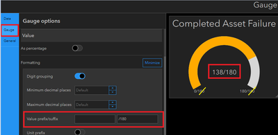

Hi Friends,
I'm configuring a gauge element in a dashboard and wanted to have a total number of the Failures to be also displayed next to the completed Failures in the center, as per the below screenshot in red color:
Any thoughts?
Abdullah_AlFazari
So to work around the above request, from the Gauge tap, I just type /180, so the figure is immediately displayed in the Gauge.
However, it would be better to not show /180 at the beginning and end of the Gauge, as per the below screenshot.
