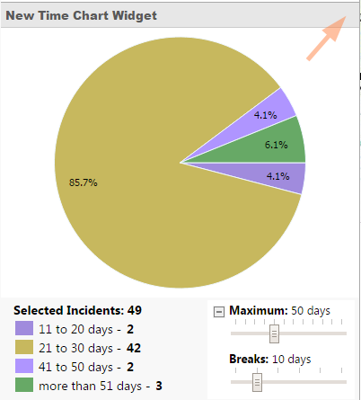

I have created a very simple widget (and I plan to create a more complex one which should work sometimes in maximized mode.)
However, when adding the widget in a panel it does not come with maximize button as built-in widgets do.

The feature is very valuable to us, now and in the future:
We've built a chart as a widget that would be too small in production with too much data to show.
Observing the D3 library gave us even more ideas for better charting data.
Unfortunately, the docked widget is too small, and then we need to expand the widget as much as possible to be able to observe data details.

And thanks for sending over the screenshot and the use case, I will bring them back to the team for discussion.
