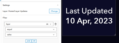

We have a dashboard that gives us a bird's eye view of some of our auto-updated content.
To accomplish this, we actually use a separate hosted table, with the columns layer and last_update_timestamp. So when our nightly script runs and updates the "sales" table, for instance, as long as the update completes without errors, the script will then update the corresponding row of this "update timestamps" table.
If I wanted a dashboard just for sales, I could then create an indicator that looks at that specific feature of the update table and display that date.
So in the situation you described, suppose that there were no new or updated features since March 15, this indicator could make it clear that the data was refreshed last night, where there would otherwise not be any other reliable timestamp on the layer itself.

CaseyC
Hi Josh,
I really appreciate your reply (as well as the example and images). This solution sounds like a good one. I assume because my dashboards are public that the hosted table would also need to be shared with everyone? Honestly, that sounds okay to me anyway because then we can also use that table as a one stop shop for people who want to know when a list of data has been last updated. I can't think of any downsides to having that be public information.
This sounds like a winner until ESRI has a built in solution. Thank you very much for offering that idea up.
Casey Carpenter
jcarlson
MVP Alum
You can make a non-editable view of the table public for transparency, but then use an editable view for your scripted updates, just to keep the data secure. But yeah, we feel the same way. We want people to know when the data was refreshed. When people think they've spotted an issue in our maps, it's often a problem somewhere upstream, but without that timestamp, you could just assume the data is stale.
