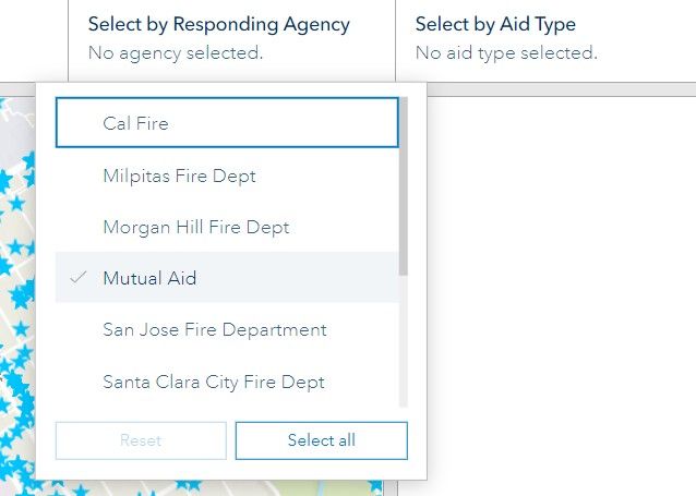

How do I display the count next to each field in the category selector of a dashboard?

As far as I know, there's no way to do this in a category selector, at least, not without using some fancy Arcade expressions. But if it's acceptable, you can use a grouped list, chart, or table to act as your category selector.

Hi Amy,
Try to enable the "Display Count" option in the category selector settings!

Where is that setting? I've not seen it.

Ok, I probably have an older version of Enterprise and the dashboard doesn't have this option yet. I'm on Enterprise 10.9 or something
