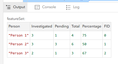

Here's one way to do that. I used a dummy dataset to test it out, so substitute your actual dataset.
var fs = FeatureSet(
    fields: [
      { alias: "Person", name: "Person", type: "esriFieldTypeString" },
      { alias: "Status", name: "Status", type: "esriFieldTypeString" }
    features: [
      { attributes: { Person: "Person 1", Status: "Investigated" } },
      { attributes: { Person: "Person 1", Status: "Pending" } },
      { attributes: { Person: "Person 2", Status: "Investigated" } },
      { attributes: { Person: "Person 2", Status: "Pending" } },
      { attributes: { Person: "Person 3", Status: "Investigated" } },
      { attributes: { Person: "Person 3", Status: "Pending" } }
var statuses = ["Investigated", "Pending"];
var people = GroupBy(fs, "Person", { name: "Total", expression: "1", statistic: "Count" });
var peopleandstats = GroupBy(fs, ["Person", "Status"], { name: "Total", expression: "1", statistic: "Count" });
var features = [];
for (var p of people) {
  var person = p.Person;
  var attr = {};
  attr["Person"] = person;
  for (var status of statuses) {
    var s = First(Filter(peopleandstats, "Person = @person AND Status = @status"));
    attr[status] = s.Total;
    if (status == "Investigated")
      attr["Percentage"] = Round(s.Total / p.Total * 100, 0);
  attr["Total"] = p.Total;
  Push(features, { attributes: attr });
var fields = [
  { name: "Person", type: "esriFieldTypeString" },
  { name: "Investigated", type: "esriFieldTypeInteger" },
  { name: "Pending", type: "esriFieldTypeInteger" },
  { name: "Total", type: "esriFieldTypeInteger" },
  { name: "Percentage", type: "esriFieldTypeInteger" }
return FeatureSet({ fields: fields, features: features });
which returns this table

Good use of the Case statement in the GroupBy function. I always overlook that as a possible solution.
I believe you'll still have to loop through the grouped Featureset to calculate the percentage.
var investigated = "CASE WHEN Status = 'Investigated'   THEN 1 ELSE 0 END";
var pending = "CASE WHEN Status = 'Pending'           THEN 1 ELSE 0 END";
var grouped = Groupby(
  fs,
  ["Person"],
    { name: "Total", expression: "Status", statistic: "COUNT" },
    { name: "Investigated", expression: investigated, statistic: "SUM" },
    { name: "Pending", expression: pending, statistic: "SUM" }
var fields = Schema(grouped).fields;
Push(fields, { name: "Percentage", type: "esriFieldTypeDouble" });
var features = [];
for (var g in grouped) {
  push(
    features,
      attributes:
          Total: g.Total,
          Investigated: g.Investigated,
          Pending: g.Pending,
          Percentage: Round(g.Investigated / g.Total * 100)
