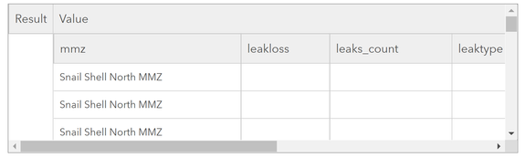

I'm writing a data expression to show which polygon (mmz) each point (leaks) resides within.  I also need to keep a few fields from the leaks feature.  I can populate the 'mmz' field, but I'm having trouble getting the other fields I need.  Here's what I have so far and the results:
var port = Portal('my portal')
var mmz = FeatureSetByPortalItem(port, 'c879aa9267604224a3f6d492fc997a50', 7,['ZONE_NAME'],true)
var leaks = FeatureSetByPortalItem(port, '44fa0f9330e449c289dfadf2553d805b', 0,['leakloss','leaktype','dateshot','leaks_count','material','maindiameter'],true)
var features = []
var feat
for (var zone in mmz){
     var pts = Contains(zone,leaks)
     for (var pt in pts){
          feat = {attributes:{
               mmz:                 zone ['ZONE_NAME'],
               leakloss:            pt ['leakloss'],
               leaktype:           pt ['leaktype'],
               dateshot:          pt ['dateshot'],
               leaks_count:     pt ['leaks_count'],
               material:            pt ['material'],
               maindiameter: pt ['maindiameter']
Push(features,feat)
var dict = {
     fields: [
          {name: "mmz", alias:"Zone", type:"esriFieldTypeString"},
          {name: "leakloss", alias:"Gallons Lost", type:"esriFieldTypeInteger"},
          {name: "leaks_count", alias:"Number of Leaks", type:"esriFieldTypeInteger"},
          {name: "leaktype", alias:"Leak Type", type:"esriFieldTypeString"},
          {name: "dateshot", alias:"Date", type:"esriFieldTypeDate"},
          {name: "material", alias:"Material", type:"esriFieldTypeString"},
          {name: "maindiameter", alias:"Diameter", type:"esriFieldTypeInteger"},
     geometryType:"",
     features:features
return FeatureSet(Text(dict))
Results:

I don't really see anything obviously wrong with the expression... You've confirmed the fields in the points layer has values, and that they're compatible with an integer field?
Data Expressions also tend to have trouble with Date fields. Try replacing this line:
with this:
dateshot: Number(pt['dateshot']),
Also, there are spaces between zone / pt and the bracketed attribute name, and there shouldn't be.

ChelseaTabor
Adding the Number function to the date field worked, but I also had to add the Text function to string field types for those values to show up.
Thanks for your help.
