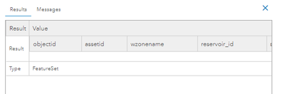

Hello!
I'm quite new to using data expressions with dashboards. My data contains water sample results and i wanted to assign a value for each period/date ranges. The data was filtered by different date ranges and I assigned them a value and wrote them in a new table.
It worked just fine. However, when I tried to return a FeatureSet from the Dictionary, it's not returning any values even if the dictionary has features. Not sure what I'm missing...
Here's the code I wrote for reference:
