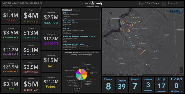

I have an existing Dashboard with Construction data on it. I've encountered a lot of issues with this data specifically where the data would just go corrupt suddenly and the dashboard would be unavailable. I've had to re-build this dashboard multiple times over the years, and recently, I just re-created the data from scratch to see if it would resolve the reoccurring issues.
Now that everything is resolved (yay!)... long story short, I don't want to modify anything unnecessarily, especially if it sends my data into a tailspin again. So here is my question.
The intention of this dashboard is to see where our money is spent on Construction. The data is formatted by Funding Source, as you can see below. Many projects span multiple municipalities, so I have one field that just lists them out so they can be displayed on the pop-up.

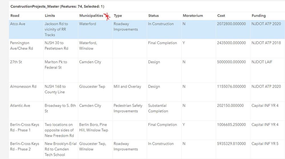

For the new Dashboard, they want the same data displayed (minus the cost widgets on the left), and they just want to see "X Municipality has 3 projects", "X Municipality has 7 projects" - displayed in chart form, such as a bar chart. So that we can see where the focus is.
As I stated in the initial post, I previously had a Related Table linked to the data where I did this via the GUID & Related Table, but I was not the one who set it up (and do not have access to this person moving forward). And since I re-created the data from scratch, I did not set it up that way since Municipal counts were not requested from Administration. But now they are.
Here's an example of what the data looks like:
