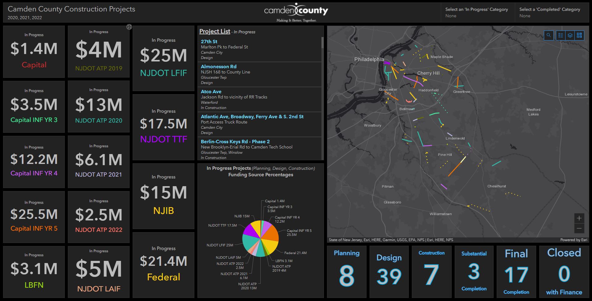

The intention of this dashboard is to see where our money is spent on Construction. The data is formatted by Funding Source, as you can see below. Many projects span multiple municipalities, so I have one field that just lists them out so they can be displayed on the pop-up.
Recently, an Administrator asked if we could display this data (in another dashboard) by Municipality. So think of bar charts rather than the $$ boxes. However, the data is not set up to display this currently, since the Municipal field I have just lists them out.

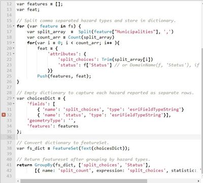

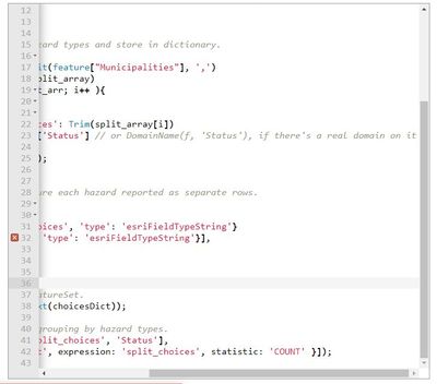

Again, data expressions are totally new for me. This is like looking a foreign language almost. I understand it a little bit from some sql I've done in the past. But anyway, I think I put in everything that I need. Do you mind looking it over and telling me if I'm missing anything? It says there's unexpected string in Line 23 (parse error), and there's also an "x" on line 32. So I must've done something incorrectly.
I've done screenshots this time. Sorry I can't get it full screen.

Anyway, the problem with line 32 is that your fields array should have a comma between each item. Line 31 ends without a comma, so there's nothing telling the expression that the two lines are different items in the array. Line 22 likewise needs a comma at the end.
