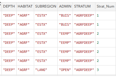

My original dataset has the field Strat_Num, which is a unique combination of Habitat, Depth, Subregion, and Admin.
I wanted to group by Stratum Number, concatenate the other values, and get their count.

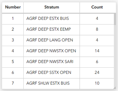

which gives me this table
