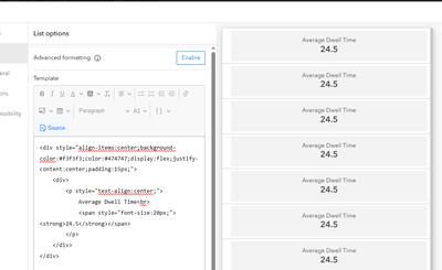

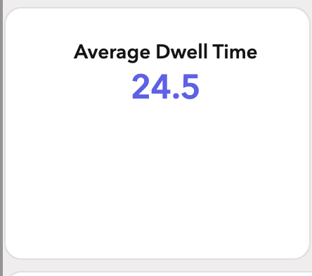

Has anyone built an ArcGIS Dashboard that vertically aligns a List Widget within the box? I have tried all sorts of HTML in the Advanced formatting, I have tried the JSON in the Assistant and I have not found any technique that achieves dynamic centering across multiple screen sizes.
Here is my existing Source code
<p style="text-align:center;">
    <strong>Average Dwell Time</strong>
</p>
<h2 style="margin:0;text-align:center;">
    <span style="color:hsl(238,72%,63%);font-size:24px;"><strong>{field/avg_dwell_time}</strong></span>
</h2>

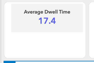

Try using flexbox to vertically align your text within the list element:
This blog post gives a good overview of flexbox and grid CSS: https://www.esri.com/arcgis-blog/products/arcgis-online/mapping/spruce-up-your-pop-ups-with-css
BJR
Unfortunately this doesn't work - across screen sizes the list widget still maintains center within the box and not the widget itself. Im no css pro but it seems like the css of the dashboard itself overrides the widget forced-css
