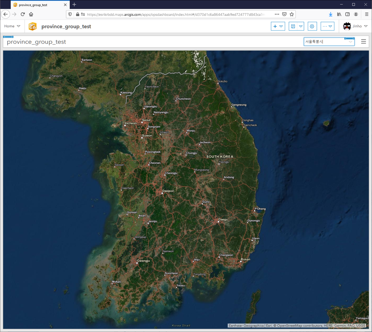

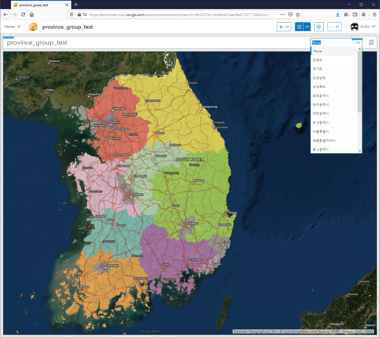

I'm trying to create a category selector in header panel to filter out the area based on province name in Korean language.
I made it sure that the correct feature layer gets filtered under the actions tab, and the interface displays everything correctly.
However, when I select one of the province, the map displays nothing. It filters out everything including the selected group value.
So I tried to convert the Korean-font-value field to english to see if it's a language issue, and it seems like it's an language/font issue.

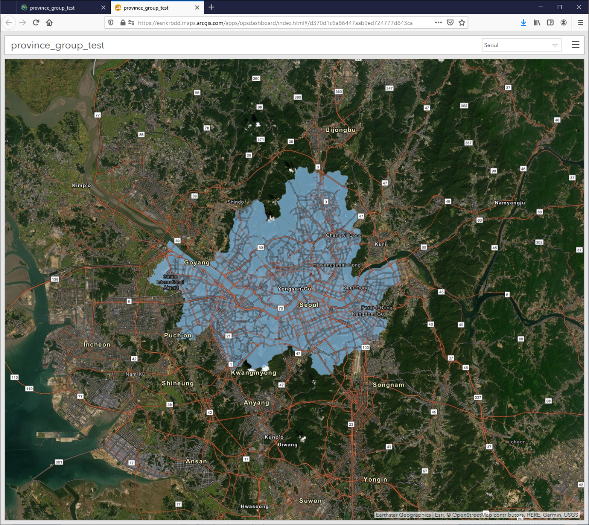

I configured the group value to use the english-converted field, and tested out the filter, and it displayed the selected value correctly. (This case, City of Seoul)

Esri Korea is assisting with this issue. Esri Case #02464614
Apparently, the "Use Standardized Queries" configuration is set to 'False' in ArcGIS Online's 'services1' server.
HQ's engineer is looking into it at the moment.
