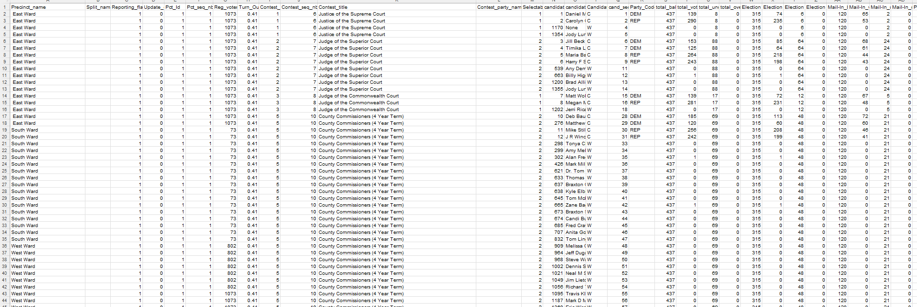

I have a dataset of voting results and I can trying to create a data expression that returns the MAX value of registered voters within each district and then add the total of each MAX value to find the total number of those registered. I have written a data expression using the GoupBy function, however, it is returning a null value. I have provided examples of my data expression and data below.
