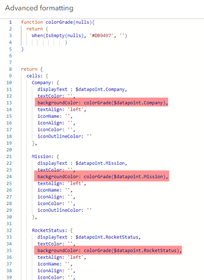

But you would need do this for every cell/field. To simplify this you can instead create a function:
function colorGrade(nulls){
  return (
    When(IsEmpty(nulls), '#DB9497', '')
And then plug in the function in every cell return statement with that specific field in the function.

JenniferAcunto
The expression you're looking for is
When(IsEmpty($datapoint.Company), '#F5DDD4', '')
  return (
- Jen
JustinH
Wow, thank you so much! This is so helpful.
