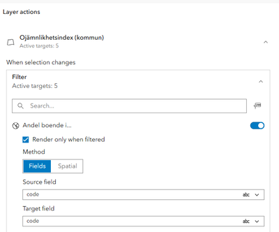

AndreasHall
You can try to use this data schema (features) for the time series, just add a column for year. On the map, configure a Layer action on the polygon layer that filters the serial chart based on name/ID. Tick Render only when filtered if you want it to only show data after a selection is made in the map.
