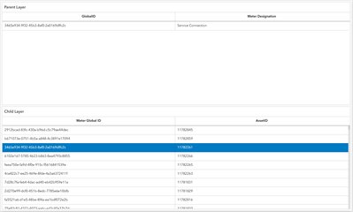

I am not sure if this is exactly what you are trying to sort out. But widget actions for filtering based on selections for widgets like tables are pretty straightforward and can be configured through the Actions tab of the widget. For instance, in the following example I have configured a filter action from my child layer to the parent layer based on selections made on the child layer table.

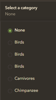

MrsVon

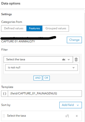

Ah, I used Grouped Values instead of Features.
When I switch to Features I can match Global/ParentID and the filter now lists all species from each incident. Any pointers to an Arcade script so I can group all the species by name and not have each listed by incident? So instead of 3 separate Bird entries I just see one and that filters all relevant incidents/locations from the parent ID?
